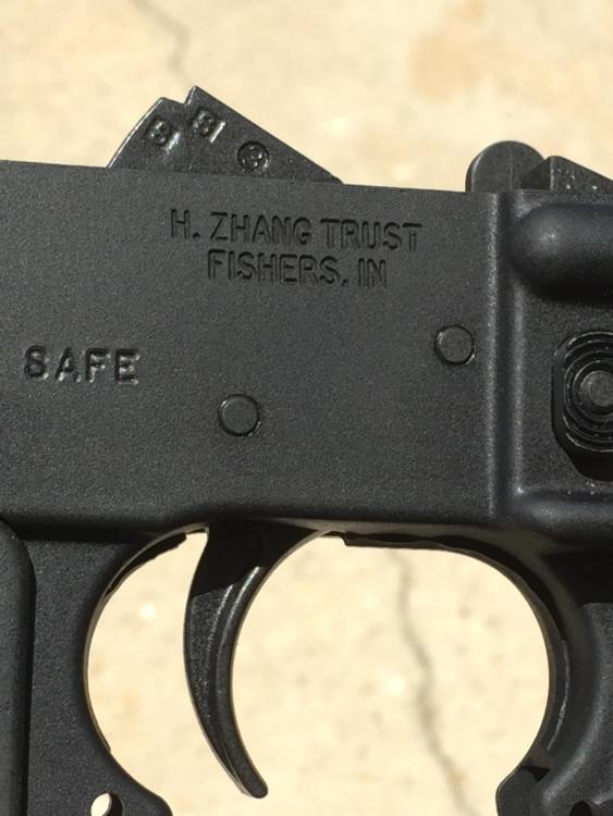

All engraving is deep cut using a rotary pantograph and generally is cut at .012” to .015” deep in aluminum or polymer and around .007” - .010 in steel or titanium. The ATF requirements are .003” minimum depth which is only about a sheet of notebook paper thick. Cutting at such a shallow depth makes refinishing difficult as such shallow markings tent to be covered or obliterated when refinishing. Most laser engraving services struggle to even hit the .003” depth; my machines can cut up to .020” deep, nearly seven times the depth required. Deep cut rotary engraving can also be color filled with paint or epoxy for a two toned finish; most laser engraved items cannot have this done as the engraving is not deep enough to hold paint.
Why use the old style cutting system and not laser?
You may be considering laser engraving versus rotary cutting. As stated, all engraving is cut on a rotary cutting scalable pantograph and the difference was partially explained above. If you want the engraving to hide in plain sight and blend in with the other markings on your firearm, I suggest that you compare images of laser marked engraving with deep cut rotary engraving. Most OEM manufacturers use either deep cut engraving or roll marking to mark their products; very few use laser. Unless your particular firearm was originally laser cut by the original manufacturer, deep cut rotary engraving will much more closely match your firearms existing markings and tend to blend in or hide in plain sight. I would encourage you to search the internet for example photos of both. Most laser cut engraving on aluminum or steel virtually disappears when cold bluing or aluminum oxidizer is applied – this is not the case with deep cut engraving.
