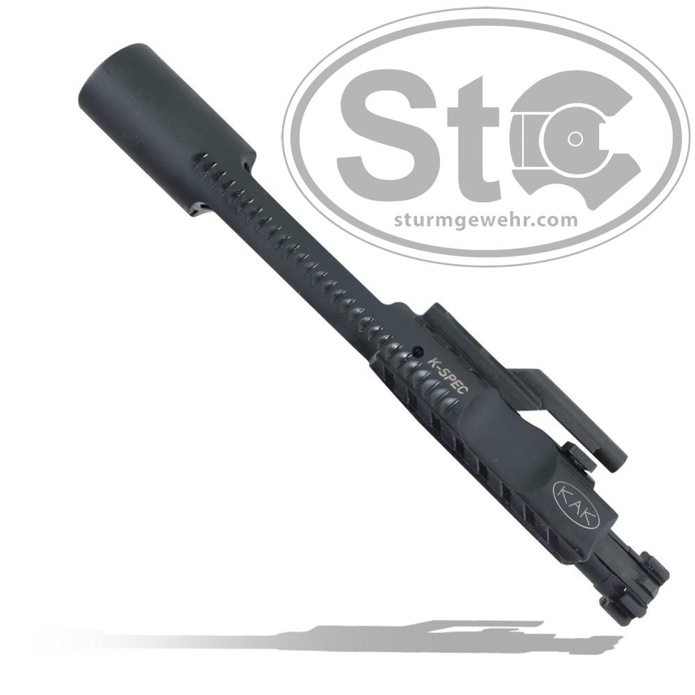

The KAK AR15 5.56mm K-SPEC Down Vent BCG (Black) combines multiple key features focused on increasing the reliability of your AR-15 style firearm no matter if you are running suppressed or unsuppressed, and regardless of conditions. The K-SPEC is a truly plug and play BCG that will accommodate whatever configuration your mission requires.
For those running suppressed, the KAK AR15 5.56mm K-SPEC Down Vent BCG requires no additional tuning or tweaking of the gas or recoil systems to run reliably. Like all of the KAK Bolt Carrier Group, the K-SPEC is machined to the M16 full auto profile.

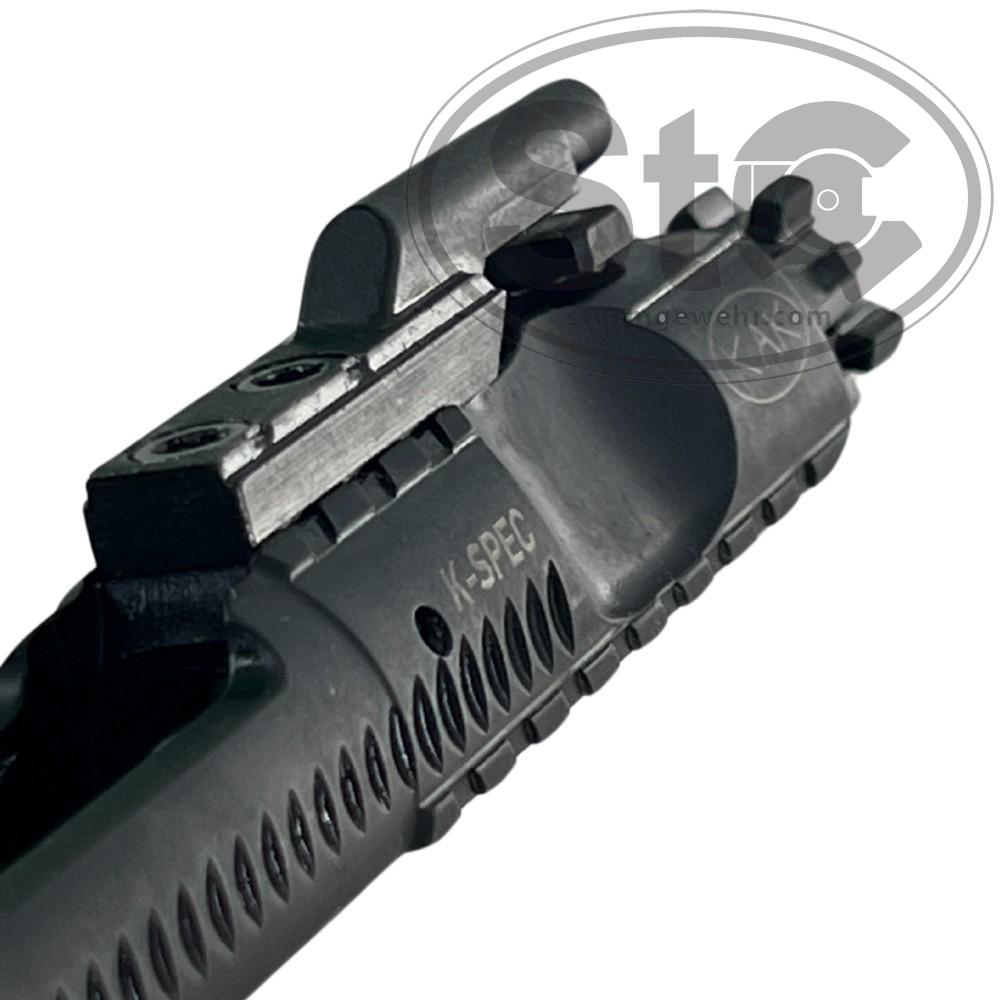

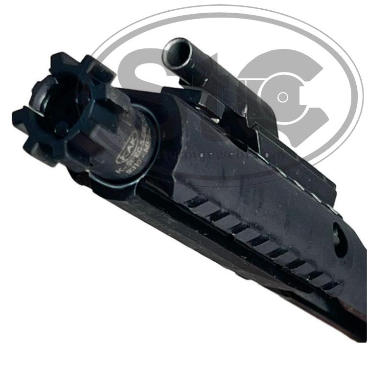

Slotted Angled Carrier Rails
For enhanced functionality in adverse and rugged conditions such as sand, mud, dirt, and grime. These rail cuts are designed for debris disbursement, resulting in ultra-high functionality in the toughest conditions, including suppressor fouling and foreign contaminates. Strategically located angle cuts in the rails result in carbon fouling and debris being moved into noncritical areas that are not in contact with the upper receiver and do not affect the function of the firearm. aka sandcutter.

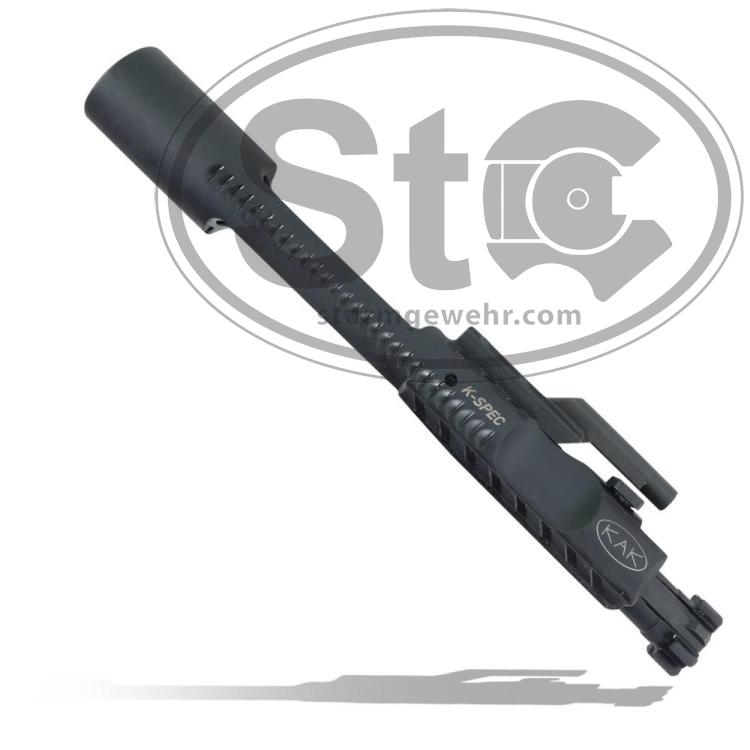

Downward Gas Vents
In an effort to reduce the amount of debris and gas vented towards the shooters face, the two standard gas relief ports have been relocated from the ejection port side of the K-SPEC carrier and placed underneath, in the magazine feed lip channels. Two additional emergency relief ports have also been added to the bottom of the carrier to mitigate structural damage in the event of a case head separation. Testing has shown that venting the gasses through the magazine well has no negative impact on the feeding or function of the magazine nor ammunition, and any added heat is negligible.

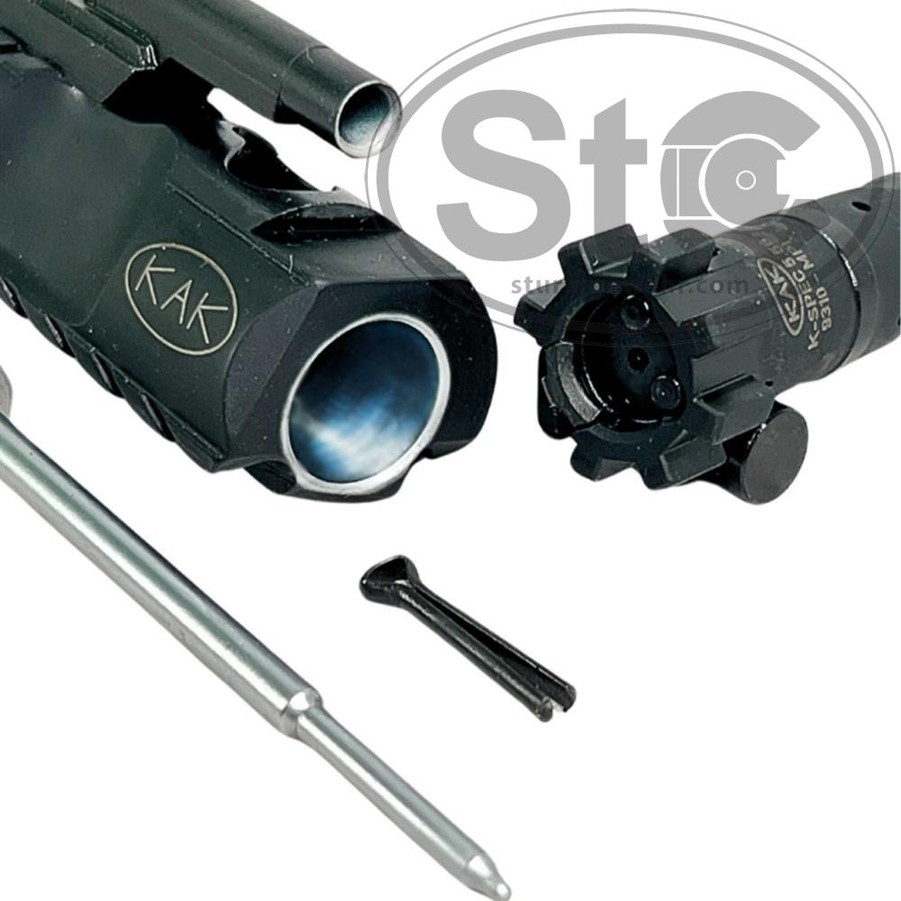

Dual ejectors
The K-SPEC dual ejector system uses mil-spec ejectors and springs that require no proprietary parts. Ejector holes are centered on the lugs to avoid any reduction in strength of the bolt. The dual ejector system increases the ejection reliability and adds consistency to the ejection pattern. KAK Industry has been manufacturing dual ejector bolts for the AR10/LR308 platform for over a decade and has used that experience to create a durable and reliable dual ejector system for the AR-15 platform.

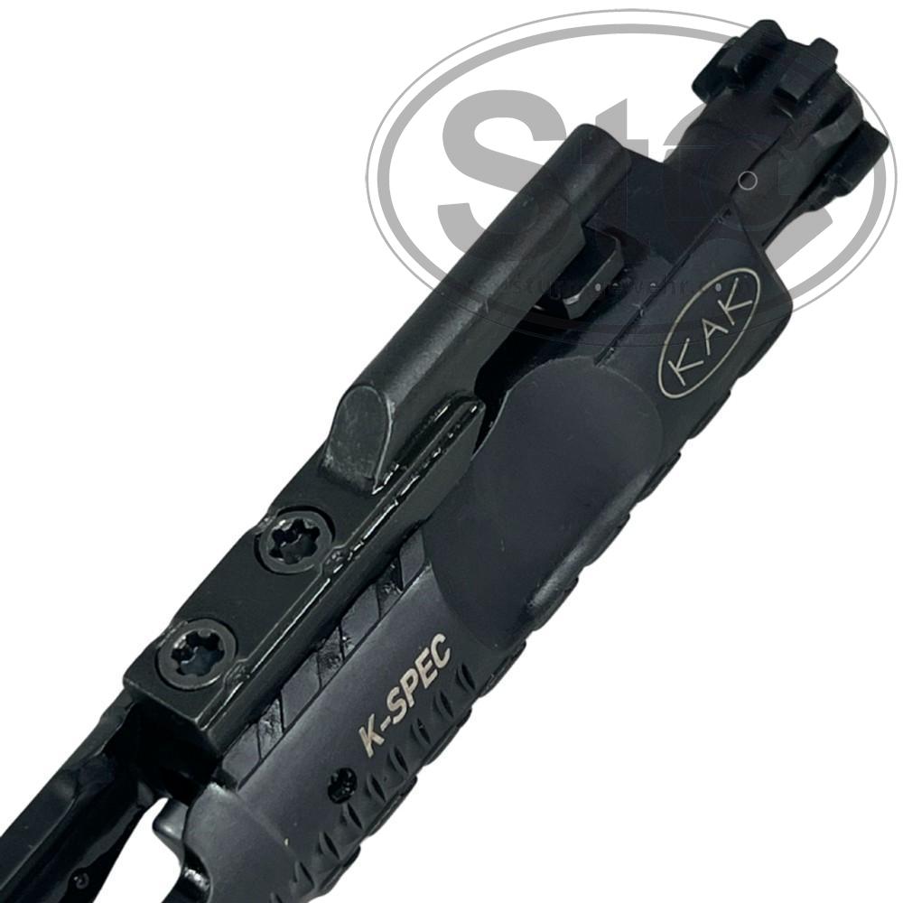

  • Permatex added between Gas Key and Carrier Mating Surface
  • Carrier- 8620 steel, outside rails, bolt runs, and gas bores ground to .0002 tolerances, chrome lined phosphate finish
  • Bolt- 9310 steel, outside diameters ground to .0002 tolerances, MPI test, phosphate finish
  • Firing Pin- 8740 steel, Swiss turned, heat treated, precision ground, chrome plated
  • Cam Pin – 4140 steel, Swiss turned, heat treated, Phosphate finish
  • Extractor- 4140 steel, fully machined, Phosphate finish
  • Extractor pin- S7 tool steel, ground, heat treated
  • Ejector- S7 tool steel, ground, heat treated
  • Gas key – 4130 steel, heat treated, secured with T25 torx fasteners, torqued to spec, staked with  hydraulic staking machine, Chrome lined phosphate
