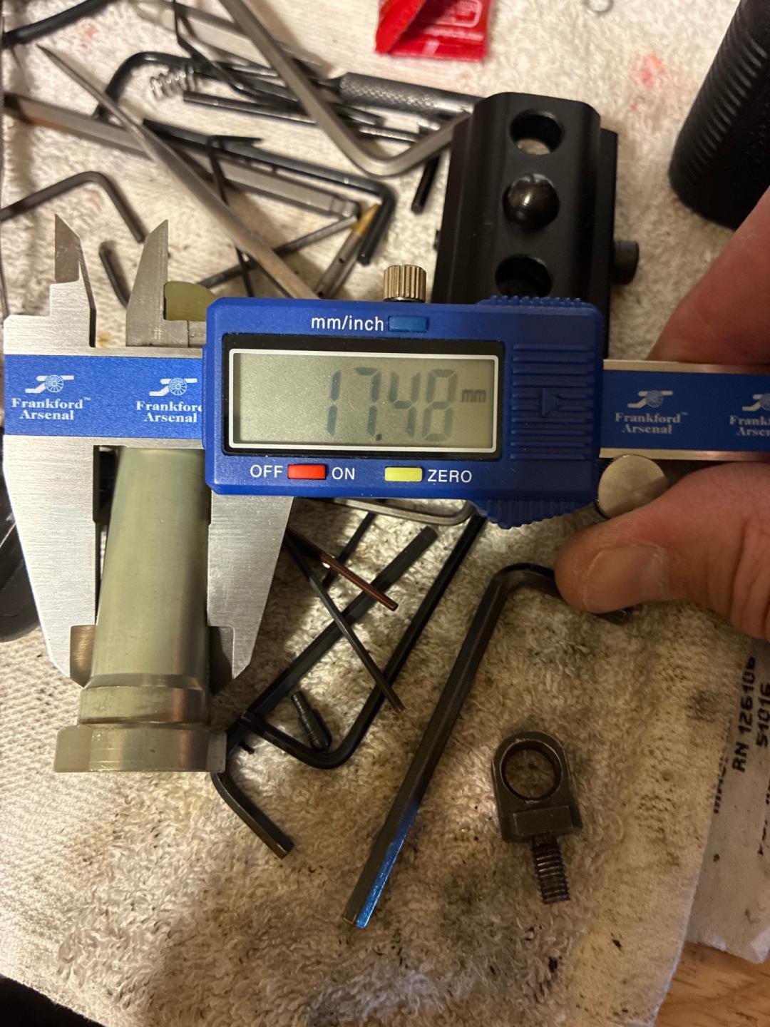

Rodney's Distributors Posted April 10 Report Share Posted April 10 A standard AR-15 carbine buffer has an outside diameter of approximately 0.99 to 1.0 inches (roughly 25 mm), designed to move freely inside both MIL-spec and commercial receiver extensions. While weights vary (3.0–5.4+ oz), the diameter remains consistent to ensure proper cycling within the tube. Key Considerations for Buffer Diameter: Buffer Diameter: The buffer body is 1-inch in diameter, which is intentionally smaller than the inner diameter of the buffer tube (which is 1.148" for Mil-spec or 1.168" for commercial) to prevent binding. Quote Link to comment Share on other sites More sharing options...
Ryanjj Posted April 10 Author Report Share Posted April 10 Hmmmmmm……. I just got this from another member. Maybe his caliper is off as your saying it has a 1” diameter? Or are you referring to the “Step up” section. Quote Link to comment Share on other sites More sharing options...
