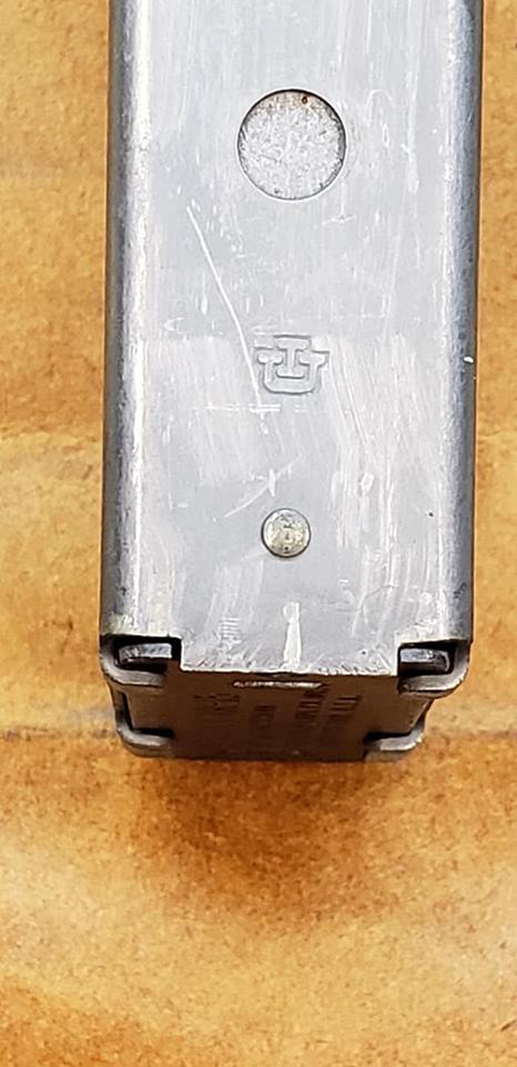

MPFiveO Posted November 10 Report Share Posted November 10 11 minutes ago, AGG said: 20-round (COLT AR-15/CAL. 5.56 MM/COLT’S FIREARMS DIVISION/COLT INDUSTRIES/HARTFORD, CONN. U.S.A. on the baseplate) would be correct for a 1977 manufacturing. Tony Would those be the ones manufactured by Universal Industries with the UI stamp on the front of the body? If so, I have a pile of those. They're what I would call high gloss, not the really dull anodizing. Im trying to also recall what year Adventure Line started making magazines for the M16. Those I believe are era correct also. To the OP, welcome to the addiction of collecting Colt AR related stuff. It won't stop with just one magazine. Quote Link to comment Share on other sites More sharing options...

MPFiveO Posted November 10 Report Share Posted November 10 Found this on Colt AR-15 Resource. These have packaging dated 1983. But they are the mags I was thinking of. Contracted from Universal Industries. https://thecoltar15resource.com/20-round-magazine-military-packaging-1983/ Quote Link to comment Share on other sites More sharing options...
AGG Posted November 11 Report Share Posted November 11 (edited) 20 hours ago, MPFiveO said: Would those be the ones manufactured by Universal Industries with the UI stamp on the front of the body? If so, I have a pile of those. They're what I would call high gloss, not the really dull anodizing. Im trying to also recall what year Adventure Line started making magazines for the M16. Those I believe are era correct also. To the OP, welcome to the addiction of collecting Colt AR related stuff. It won't stop with just one magazine. Not certain on the "UI" on the magazine body--- probably aftermarket subcontractor. Tony Edited November 11 by AGG 1 Quote Link to comment Share on other sites More sharing options...
AGG Posted November 11 Report Share Posted November 11 (edited) 17 hours ago, huggytree said: https://www.gunbroker.com/item/1136853890 is this the correct mag? Negative--- COLT AR-15/CAL. 5.56 MM/COLT’S FIREARMS DIVISION/COLT INDUSTRIES/HARTFORD, CONN. U.S.A. on the baseplate for a 1977. That would be more correct for late 1965/1966/1967 with no white circular sticker and no “1” in a circle) with metal follower (COLT AR-15/CAL. .223/COLT’S PT. F.A. MFG. CO. INC./HARTFORD, CONN. U.S.A. on baseplate). Tony Edited November 11 by AGG Quote Link to comment Share on other sites More sharing options...

AGG Posted November 11 Report Share Posted November 11 (edited) 1 hour ago, MPFiveO said: Found this thread documenting evolution, but nothing that would say exactly which mag came with a 1977... https://ar15.com/forums/ar-15/Development-of-the-AR-15-Magazine-and-Photo-Resource-Thread/123-784346/ I base my observations on chronicling firearms data for 35+ years, and on NIB samples that I have actually seen. The data post can be seen on HK PROSHOP (HK MARKETPLACE/HK COLLECTIBLES AND SWAG FOR SALE/FOREARMS REFERENCE DATA). Tony Edited November 11 by AGG Quote Link to comment Share on other sites More sharing options...

MPFiveO Posted November 11 Report Share Posted November 11 3 hours ago, AGG said: I base my observations on chronicling firearms data for 35+ years, and on NIB samples that I have actually seen. I've been doing the same thing for the same amount of time. I'm just getting forgetful these days and have to refer back to reference material, of which I have a lot. I still have a 66, 75 and a few 80's era SP1's. I try to keep the correct magazines with the guns but things get moved around. I have hundreds of AR mags and not all of them are special or specific to a particular model. I do know this, I have a box of Circle 1 mags that go with my XM16E1 and 1966 SP1. These typically have silver floor plates and will be marked .223. There are variations in the .223 marked floor plates where the .223 stamp will be larger or smaller. Also the 1 in the circle might be right side up, upside down, or not even there, just a circle. I have examples of each. I also have some mags like you describe that came out of boxes containing unfired Colt M16A1 rifles. The boxes are dated 1975. I'll have to dig them out to see if they were marked with the Universal Industries logo on the front. I believe that they are. Universal Industries was not just an aftermarket magazine supplier, they had a military contract going back to 69? I can't recall. They supplied magazines with Universal marked floor plates as well as Colt marked floor plates. So, they are factory Colt magazines. There were Colt 5.56 magazines that did not have the UI logo on the front of the magazine. Most of those had a deep orange color after the dry film lube wore off. I don't know if these were made by Colt or another contractor but they have Colt 5.56 marked floor plates. I don't recall the date of manufacture on those as I'm getting forgetful... Quote Link to comment Share on other sites More sharing options...
MPFiveO Posted November 11 Report Share Posted November 11 Does anyone recall what year Colt started putting the block in the 20 round magazines to limit them to 5 rounds? And did all of them have a rivet in the floor plate? All of the examples I've collected had black plastic floor plates and appear to have come with rifles made in the 1980's. I've never come across one with a metal follower. Quote Link to comment Share on other sites More sharing options...
