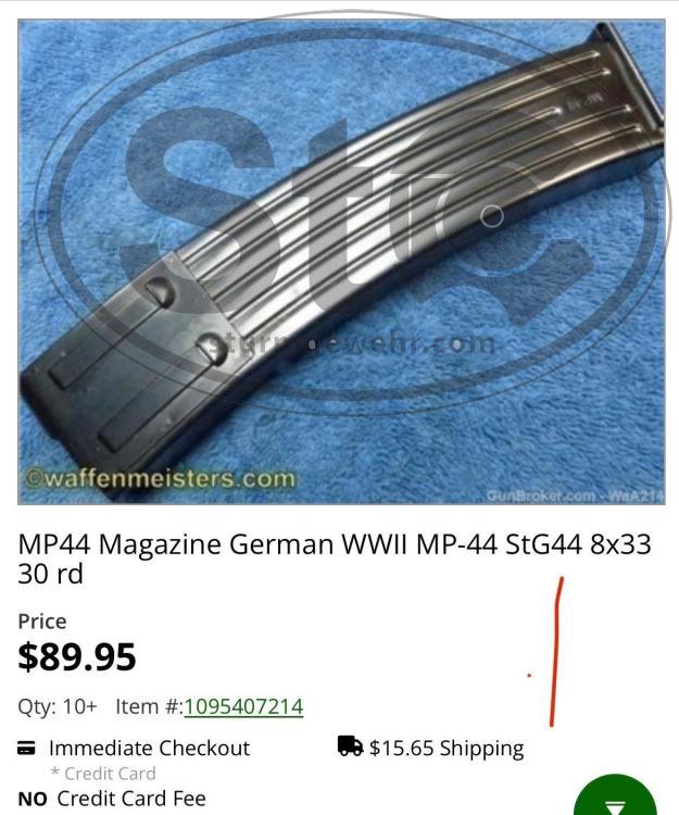

SGAmmo Posted March 22, 2025 Report Share Posted March 22, 2025 Hey guys, I picked up a mp44 recently and it came with one mag but I would like to have a few more. Does anyone know of a source for original mags other than gunbroker? I see some aftermarket mags for $90 each. Has anyone used these to see if the work as they should? Quote Link to comment Share on other sites More sharing options...

SGAmmo Posted March 25, 2025 Author Report Share Posted March 25, 2025 I ordered a few of these $89 ones, if anyone cares, I'll test them in a week or so 1 Quote Link to comment Share on other sites More sharing options...
Beatone Posted April 6, 2025 Report Share Posted April 6, 2025 My understanding is those 90.00 mags have to be modified to work with a MP44. There was a guy on gunbroker (MG34gunner i believe) who was modifying the feed ramps to make them work properly. He sold them a few years back for 149.00. I haven't sean him sell any lately. I did buy one but haven't got around to testing it. Quote Link to comment Share on other sites More sharing options...
FreeinAZ Posted April 8, 2025 Report Share Posted April 8, 2025 My experience has been poor. Bought 2 from the company mentioned and neither would fit into the mag well of my MP43. Sent them back. Bought 2 more at a higher price from Legacy, they fit into the mag well, but do not feed at all. All rounds point down. You could tell this was going to happen just by loading them. If anybody knows of a source of reliable mags, I'm all ears. Paying $700+ for a mag sucks. Quote Link to comment Share on other sites More sharing options...

sswift Posted November 12, 2025 Report Share Posted November 12, 2025 My $90 repro works fine when loaded to 25 or less. Absolutely doesn’t work above 25. Quote Link to comment Share on other sites More sharing options...
gftiv Posted November 12, 2025 Report Share Posted November 12, 2025 Privi ammo does not work well in my gun. The cartridge is about .010" smaller than WWII ammo at the base of the neck. This causes the cartridge to not point up as much as needed to feed right. 20 rds work ok. reloads work OK because the brass is blown out that .010" needed to feed right. Quote Link to comment Share on other sites More sharing options...

JBurke Posted December 25, 2025 Report Share Posted December 25, 2025 On 11/12/2025 at 6:03 PM, gftiv said: Privi ammo does not work well in my gun. The cartridge is about .010" smaller than WWII ammo at the base of the neck. This causes the cartridge to not point up as much as needed to feed right. 20 rds work ok. reloads work OK because the brass is blown out that .010" needed to feed right. I run PRVI/PPU exclusively and I have multiple original magazines. I have no reproduction or even postwar 1001 magazines. Yes, I have had the occasion failure to feed and random stovepipes, but it is fully dependent on the magazine being used. Now that I've tested all 15 of my original magazines, I've determined which magazines perform best (as in flawlessly) and which need tweaking. Loading to the full 30 and the rifle feeding and running flawlessly is no issue either, but again, it's all due to which magazine I'm using. 2 Quote Link to comment Share on other sites More sharing options...
