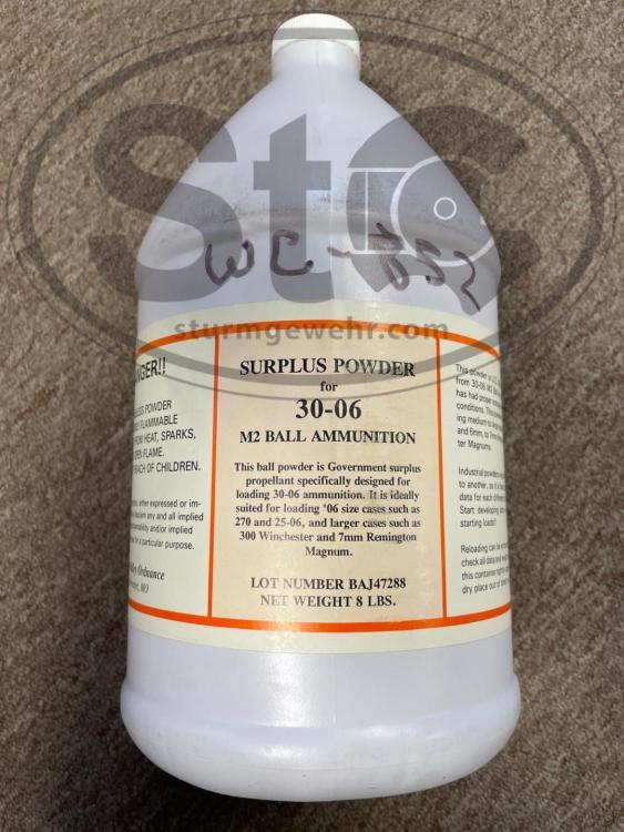

BillR Posted February 12, 2025 Report Share Posted February 12, 2025 I have an 8 lb. of what I believe is WC-852 pulled powder and curious where I can find load data specifically for 30-06. Any information would be greatly appreciated. Bill Quote Link to comment Share on other sites More sharing options...

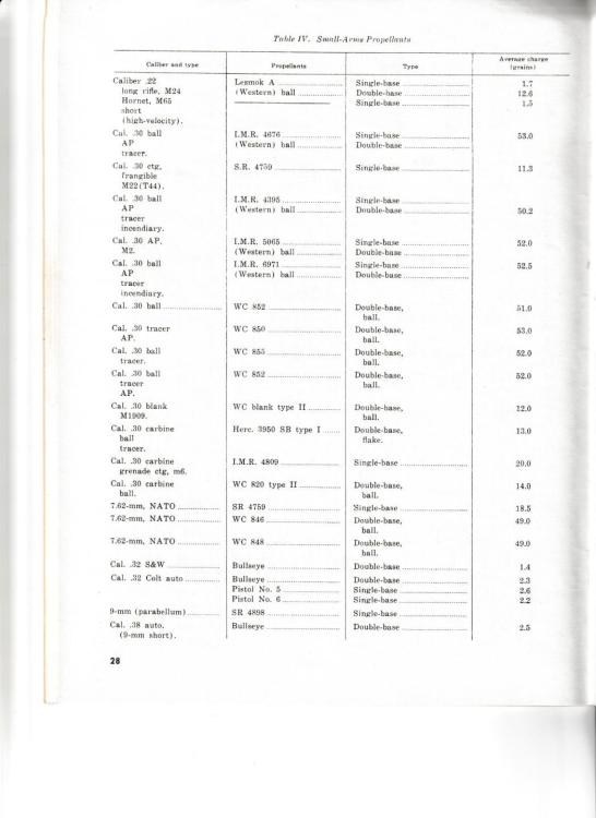

GUNBUGS Posted February 14, 2025 Report Share Posted February 14, 2025 Page 28 from the Army TM on Small Arms ammunition. Note they list "average" charge weights, I'm sure depending on the particular lot of powder. Quote Link to comment Share on other sites More sharing options...
