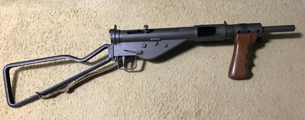

MontanaRenegade86 Posted November 16, 2022 Report Share Posted November 16, 2022 (edited) The STEN Mk. II was my first machinegun. Some things I've learned: Buy lots of magazines, sometime you have to try a few magazines to find one that works well. Don't grasp the mag-well during shooting, get a forward grip. Invest in some spare trigger control parts. The Magnum/7.62x25 STEN is hella fun, but make sure you have a strong recoil spring. Dump the "T" stock and get a loop stock. Buy lots of ammo. The STEN is a big hit at the range. Overall, the STEN is a great entry level machinegun. Pretty reliable and easy to troubleshoot. In liberty, KristopherH ETA: Mine was made by Ciener. One of the last few he put together and a bit nicer than some of the older ones. Edited November 16, 2022 by MontanaRenegade86 1 Quote Link to comment Share on other sites More sharing options...
