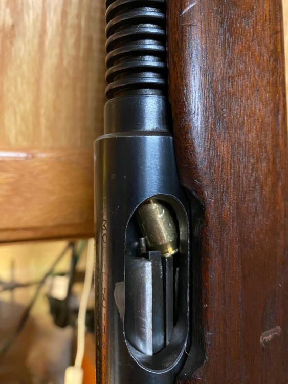

Bwanalewis Posted September 19, 2022 Report Share Posted September 19, 2022 Looking for some help. I have a Reising Model 50 WWII serial number. I am having a failure to feed with factory 20 Round Mags and Christy aftermarket 30 Rounders. It strips the round and then gets bound up. I have replaced the (I know I am saying this incorrectly) Bolt Spring and Spring connected to the charging handle under the foream with Wolf springs. I know there are some knowledgeable Reising owners out there, any thoughts? Thanks in advance for the help. Chad Quote Link to comment Share on other sites More sharing options...

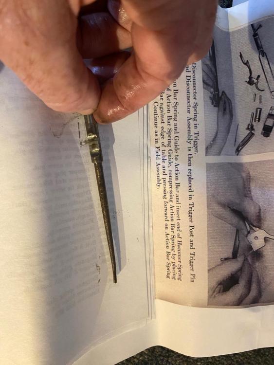

Bwanalewis Posted September 19, 2022 Author Report Share Posted September 19, 2022 I just did a little bit deeper dive into the situation. Looks like I have a bent or broken firing pin. My guess is the firing pin should not be sticking out. HA... I guess the second question is information or tricks to getting the Firing PIn out. Quote Link to comment Share on other sites More sharing options...
Kevin Bartlett Posted September 20, 2022 Report Share Posted September 20, 2022 I've had this happen before. From the looks of your photo, I'd guess the front 3/8 to 1/2 inch of your firing pin has broken off and jammed. The original pin had a long, skinny front section which was prone to breaking. The firing pin may just be bent and stuck, or it may be the tip broken off and stuck. Remove the bolt and tap the firing pin from front to rear to release it. If it is broken, replace it. If is not broken but merely stuck and not bent, you may just need to replace your firing pin spring. I carry spare firing pins in my Reising kit. You can buy repro Reising firing pins. I have a lathe, so I've made some spares from both 4140 alloy steel and 17-4 stainless steel. I've not had a pin break in years but granted, I don't shoot it as much as I once did. Let us know what you find when you remove the firing pin. Kevin in NC Quote Link to comment Share on other sites More sharing options...

Bwanalewis Posted September 20, 2022 Author Report Share Posted September 20, 2022 20 hours ago, Kevin Bartlett said: I've had this happen before. From the looks of your photo, I'd guess the front 3/8 to 1/2 inch of your firing pin has broken off and jammed. The original pin had a long, skinny front section which was prone to breaking. The firing pin may just be bent and stuck, or it may be the tip broken off and stuck. Remove the bolt and tap the firing pin from front to rear to release it. If it is broken, replace it. If is not broken but merely stuck and not bent, you may just need to replace your firing pin spring. I carry spare firing pins in my Reising kit. You can buy repro Reising firing pins. I have a lathe, so I've made some spares from both 4140 alloy steel and 17-4 stainless steel. I've not had a pin break in years but granted, I don't shoot it as much as I once did. Let us know what you find when you remove the firing pin. Kevin in NC Kevin, Thanks for the information. It was bent, and rusted. So I had a replacement titanium one. All good functions well. CL Quote Link to comment Share on other sites More sharing options...
