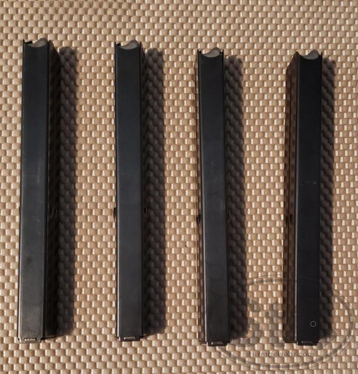

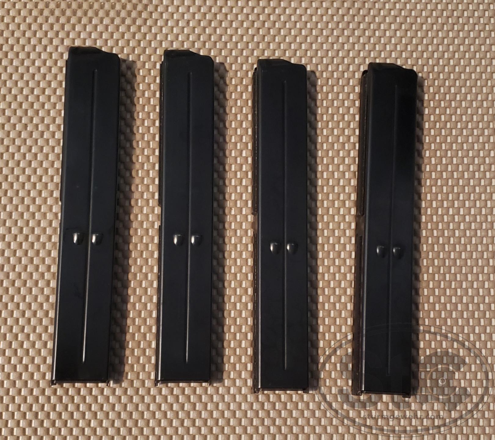

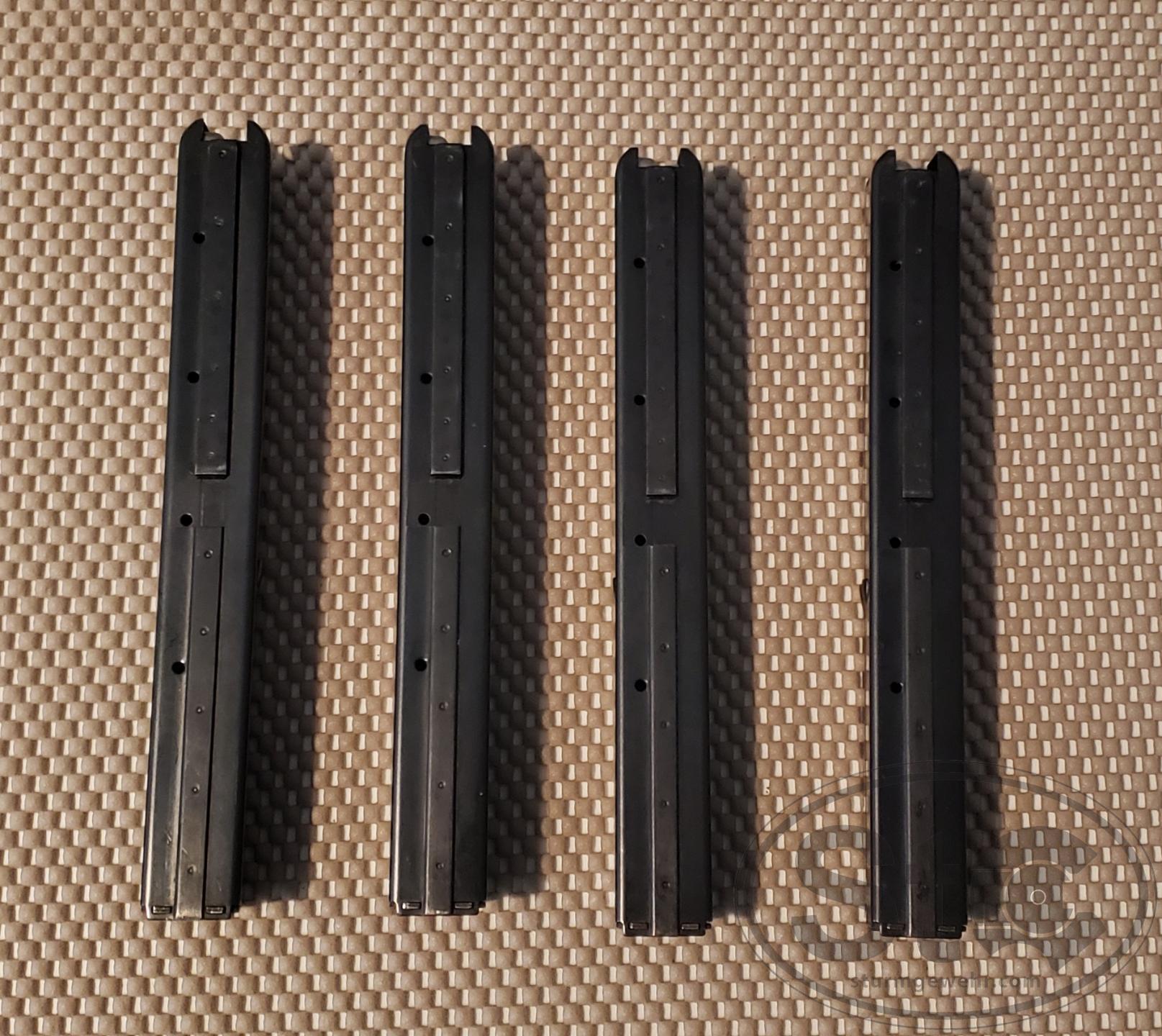

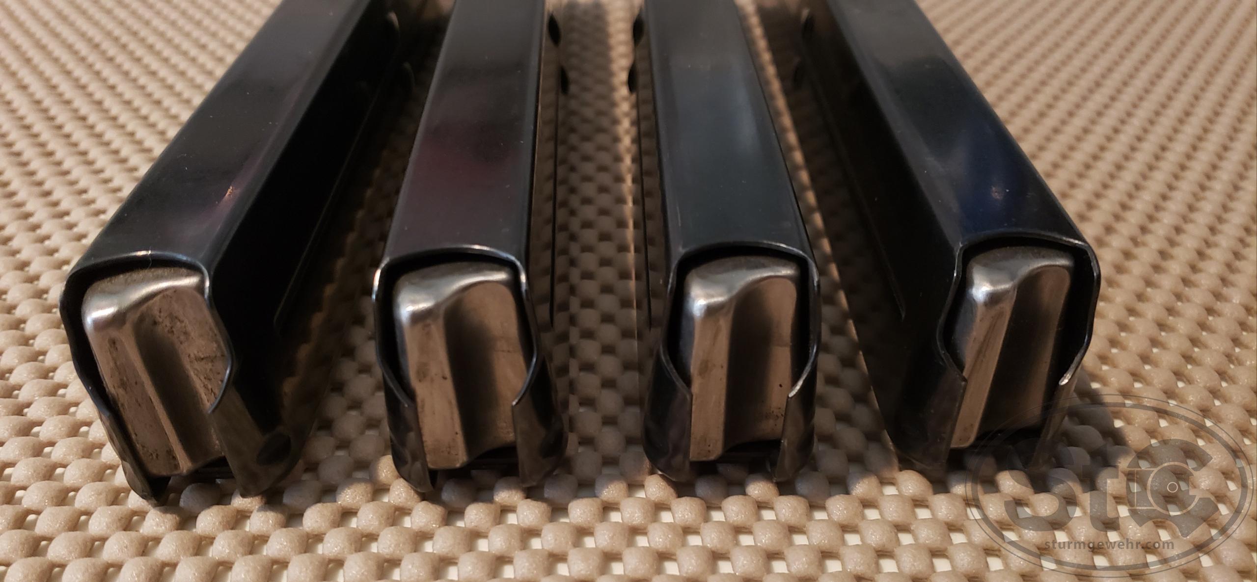

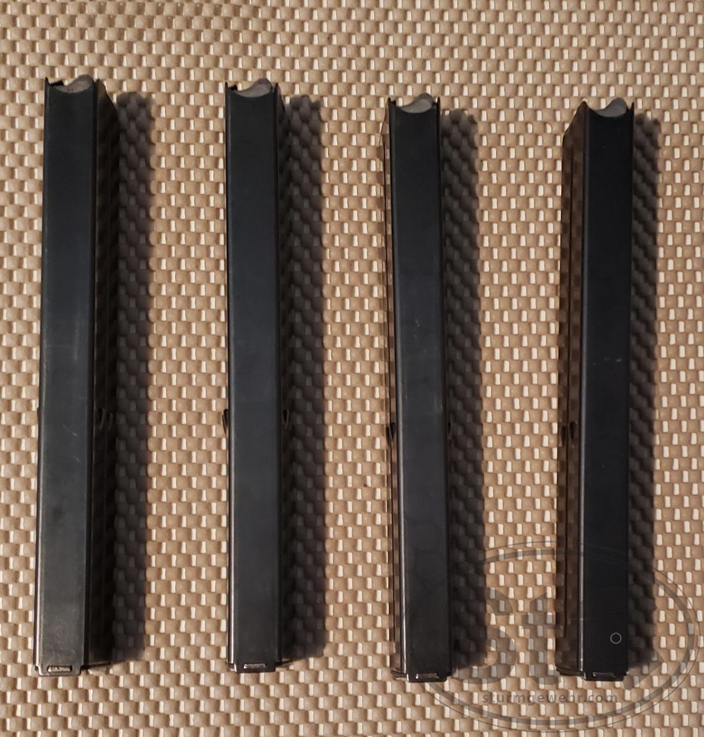

POLLC Posted February 14, 2021 Report Share Posted February 14, 2021 (edited) Four (4) NOS WALTHER 32 rd. MP 9mm magazines. $600.00 / $20.00 Priority Mail, fully insured, and tracking. Wells Fargo check, Post Office money order, Zelle priority shipping. Personal check held. Any questions please PM me. Thank you for looking. Alan PS The Walther MP 9mm fit Power Springs M10/9 9mm. Edited February 17, 2021 by POLLC To correct Tags... 1 Link to comment Share on other sites More sharing options...
Shattered Posted February 15, 2021 Report Share Posted February 15, 2021 Had me fooled for a bit, I thought title said they actually were for a Walther MPL... Link to comment Share on other sites More sharing options...
POLLC Posted February 15, 2021 Author Report Share Posted February 15, 2021 Someone please correct me if I'm wrong. They are for the Walther submachine gun. They also fit my Powder Springs Mac10/9 9mm. Link to comment Share on other sites More sharing options...

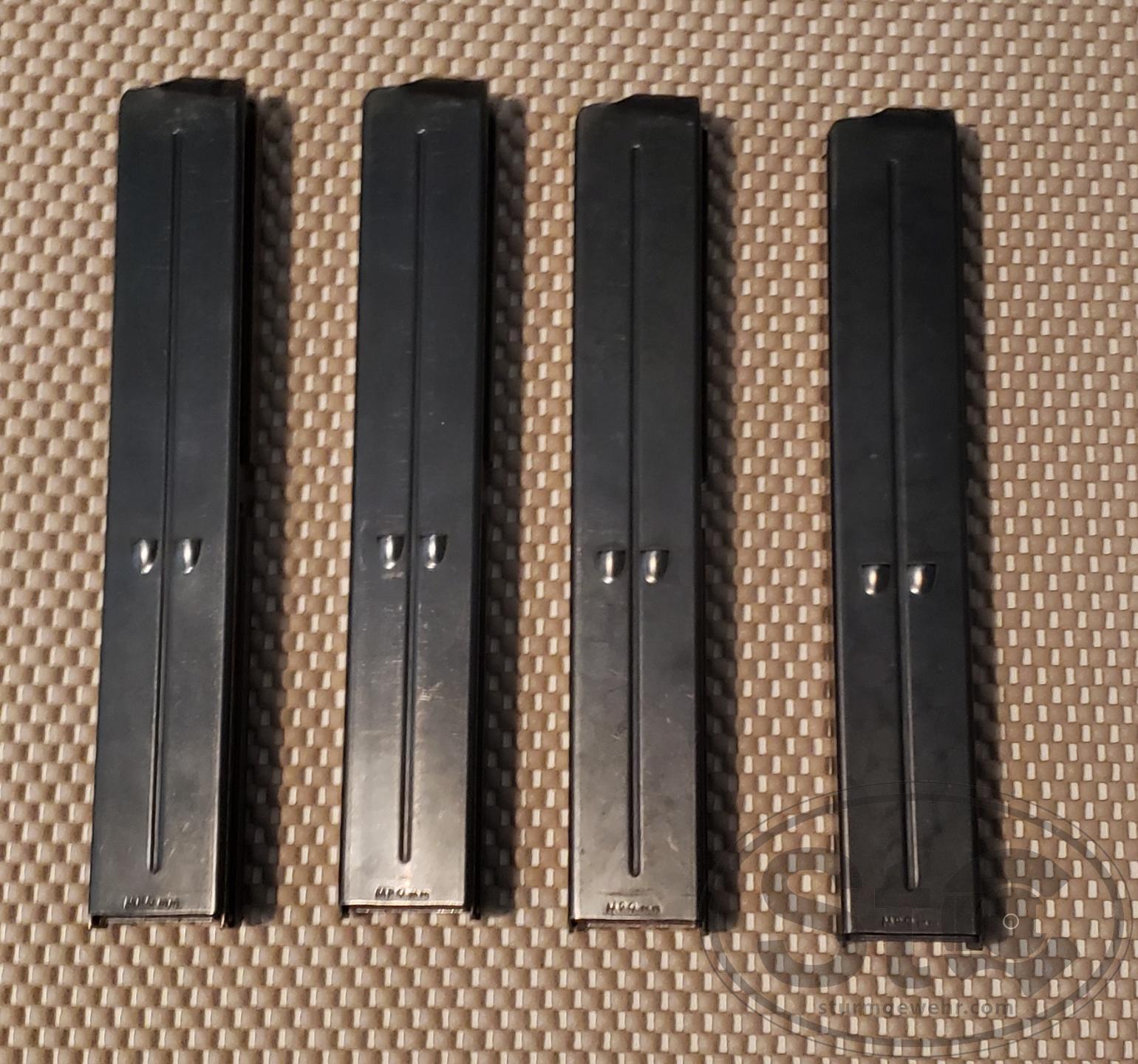

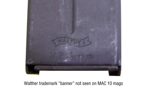

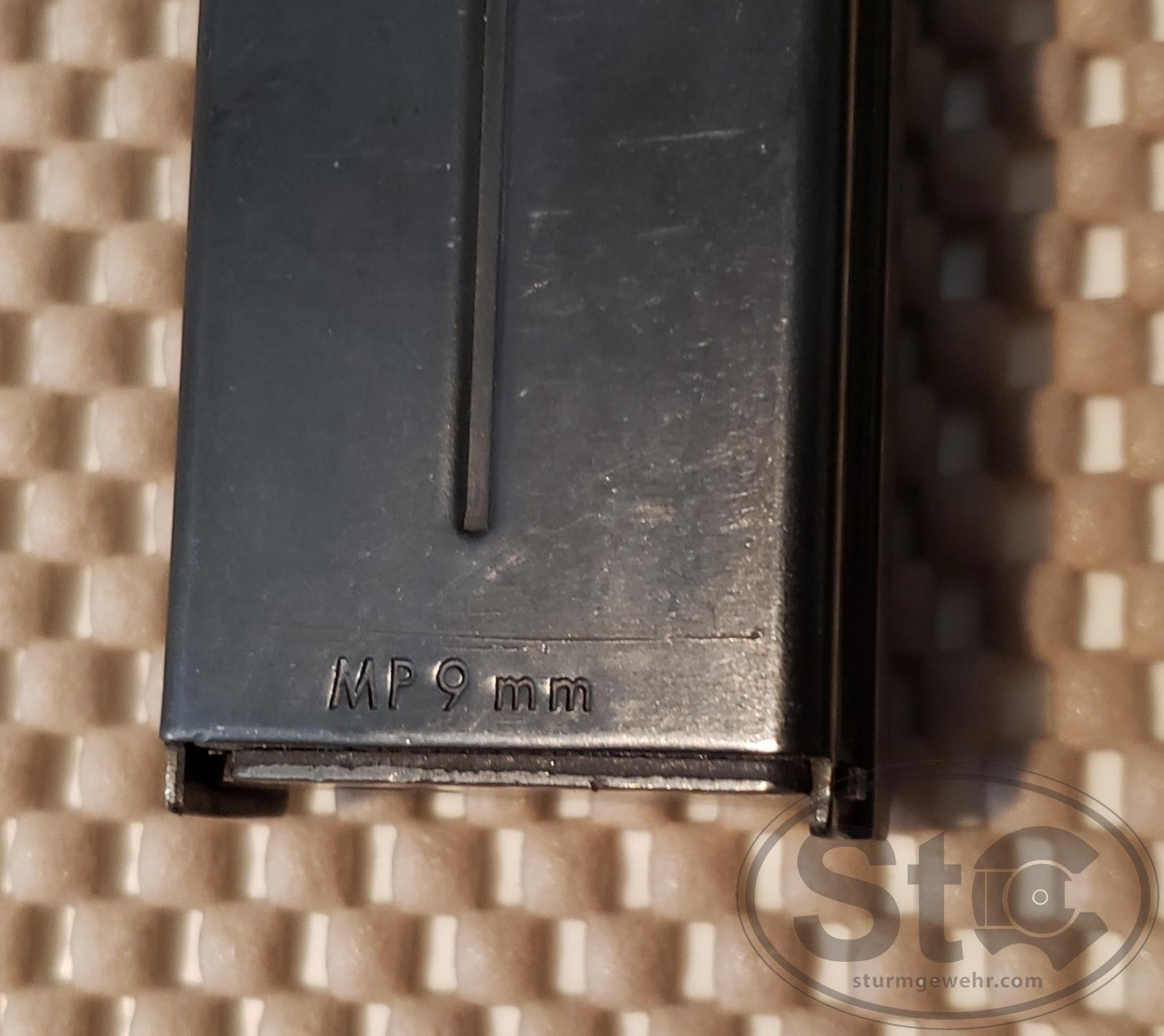

Ingram Posted February 15, 2021 Report Share Posted February 15, 2021 (edited) I have a book THE MAC MAN by Frank Iannamico and Don Thomas published 2011. According to them The Military Armament Corporation imported the 32 round Walther MPL 9mm submachine gun magazines from Germany. Slight modifications were made to the magazines to adapt them to fit and function in the Model 10.Some have the MAC/Cobray logo on them, some do not but all have MP 9mm or MPL stamped on the side. The photos in the book show those markings on the back of the magazine. The early modified ones have a rectangular stop welded to the side. The newer ones had the magazine stops press punched into the body like what you see on an MPL but lower on the body like in your photos. It looks to me that you have the ones with just the MP 9mm stamp. I have 10 that look just like yours but are marked with the MAC/Cobray logo on the front. They function flawlessly in my Powder Springs M10. Edited February 15, 2021 by Ingram Adding more Information 2 Link to comment Share on other sites More sharing options...

Thumpy Posted February 16, 2021 Report Share Posted February 16, 2021 Mpl mags will not work in the m10 with out modifications. At least the mpl mags I bought won’t work with out modifications. 1 Link to comment Share on other sites More sharing options...
Ingram Posted February 16, 2021 Report Share Posted February 16, 2021 Those are modified MPL magazines made for the MAC 10 9mm. Google MAC 10 Magazines and look for Mags for MACs - Small Arms Review. That has additional information on these, and all of the other MAC magazines. 1 Link to comment Share on other sites More sharing options...

theMexican Posted February 16, 2021 Report Share Posted February 16, 2021 On 2/15/2021 at 2:23 PM, Ingram said: I have a book THE MAC MAN by Frank Iannamico and Don Thomas published 2011. According to them The Military Armament Corporation imported the 32 round Walther MPL 9mm submachine gun magazines from Germany. Slight modifications were made to the magazines to adapt them to fit and function in the Model 10.Some have the MAC/Cobray logo on them, some do not but all have MP 9mm or MPL stamped on the side. The photos in the book show those markings on the back of the magazine. The early modified ones have a rectangular stop welded to the side. The newer ones had the magazine stops press punched into the body like what you see on an MPL but lower on the body like in your photos. It looks to me that you have the ones with just the MP 9mm stamp. I have 10 that look just like yours but are marked with the MAC/Cobray logo on the front. They function flawlessly in my Powder Springs M10. Are the mags with the logo early production you think? Or is it just random luck? I have a few myself with the MAC logo on them. Link to comment Share on other sites More sharing options...
Ingram Posted February 16, 2021 Report Share Posted February 16, 2021 I think it's just random luck. I pulled my mags out of my safe today and looked at them. I have two that came with the gun. One has the MAC/Cobray logo on it, and one does not. Both have the MP9 mm mark on them. I have some others I purchased from from Ruben Mendiola back in 1999 that have both the MAC/Cobray logo and the MP9 mm markings. I've read that some had a number or letter underneath the MAC/Cobray logo. Look up the Small Arms review article. 1 Link to comment Share on other sites More sharing options...

theMexican Posted February 17, 2021 Report Share Posted February 17, 2021 4 hours ago, Ingram said: I think it's just random luck. I pulled my mags out of my safe today and looked at them. I have two that came with the gun. One has the MAC/Cobray logo on it, and one does not. Both have the MP9 mm mark on them. I have some others I purchased from from Ruben Mendiola back in 1999 that have both the MAC/Cobray logo and the MP9 mm markings. I've read that some had a number or letter underneath the MAC/Cobray logo. Look up the Small Arms review article. Ya mine have a number 4 on them...The small arms article review is on this forum? Link to comment Share on other sites More sharing options...
Ingram Posted February 17, 2021 Report Share Posted February 17, 2021 1 hour ago, theMexican said: Ya mine have a number 4 on them...The small arms article review is on this forum? My book shows that some were marked with a number 4 and a letter Q. No, the Small Arms review article isn't on this forum. You'll have to google MAC 10 Magazines, and look for MAGs for MACs to find it. I see you're from Marietta GA! What's it like there? That's were Military Armament Corporation moved to after closing their Powder Springs operation. Link to comment Share on other sites More sharing options...

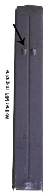

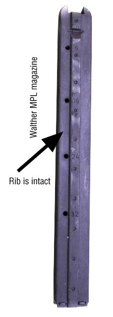

Frank I Posted February 17, 2021 Report Share Posted February 17, 2021 (edited) The magazine pictured are indeed the "Walther" mags for 9mm MAC 10, but they won't work in a Walther MPL because the stop tabs are in a different location. As far as Cobray markings some magazines have them, some do not. I have seen 1971-72 era boxes of 4 NIW magazines, some were Cobray marked some were not. From my observations, most were NOT cobra marked. Here is a link to the magazine article. https://www.smallarmsreview.com/display.article.cfm?idarticles=1814 Link for the MAC MAN book everything you need to know about MACs; Powder Springs, Marrietta, RPB, SWD, Texas Macs, NJ MACs etc. semi and subguns https://www.chipotlepublishing.com/product/the-mac-man-gordon-b-ingram-and-his-submachine-guns/ Edited February 17, 2021 by Frank Iannamico 3 Link to comment Share on other sites More sharing options...
